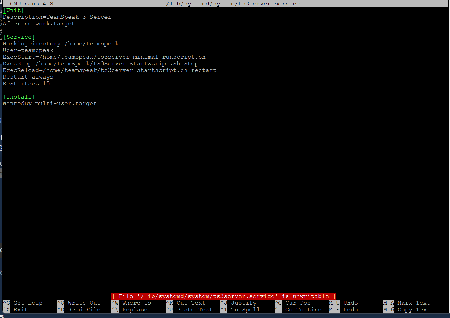

Hmm, on that second picture you sent, it seems to me that there might be an issue with the command you are using to start your TeamSpeak 3 server.
Can you send the script you use to start the server if you set it up in /lib/systemd/system/ts3server.service?
of course the command is
./ts3server start
my lib configuration is the following
Everything is fine. Your unit file looks good and there is no error in the log of the last picture in your first post. The server is up and running. If you still can not connect, it might be an issue related to the firewall or routing.

I think your main problem is that you want to run the server twice.
It is running as a systemd unit and you can check whether that instance is running using
systemctl status ts3server
If it says active (running), then the server is, well, active and running already and you won’t be able to start it using the start script.
If you want to use the start script instead of the systemd unit, you first need to stop the unit with
systemctl stop ts3server
Only then can you run ./ts3server_startscript.sh!
So, in conclusion, you can run the server as either a systemd unit or manually, not both.
