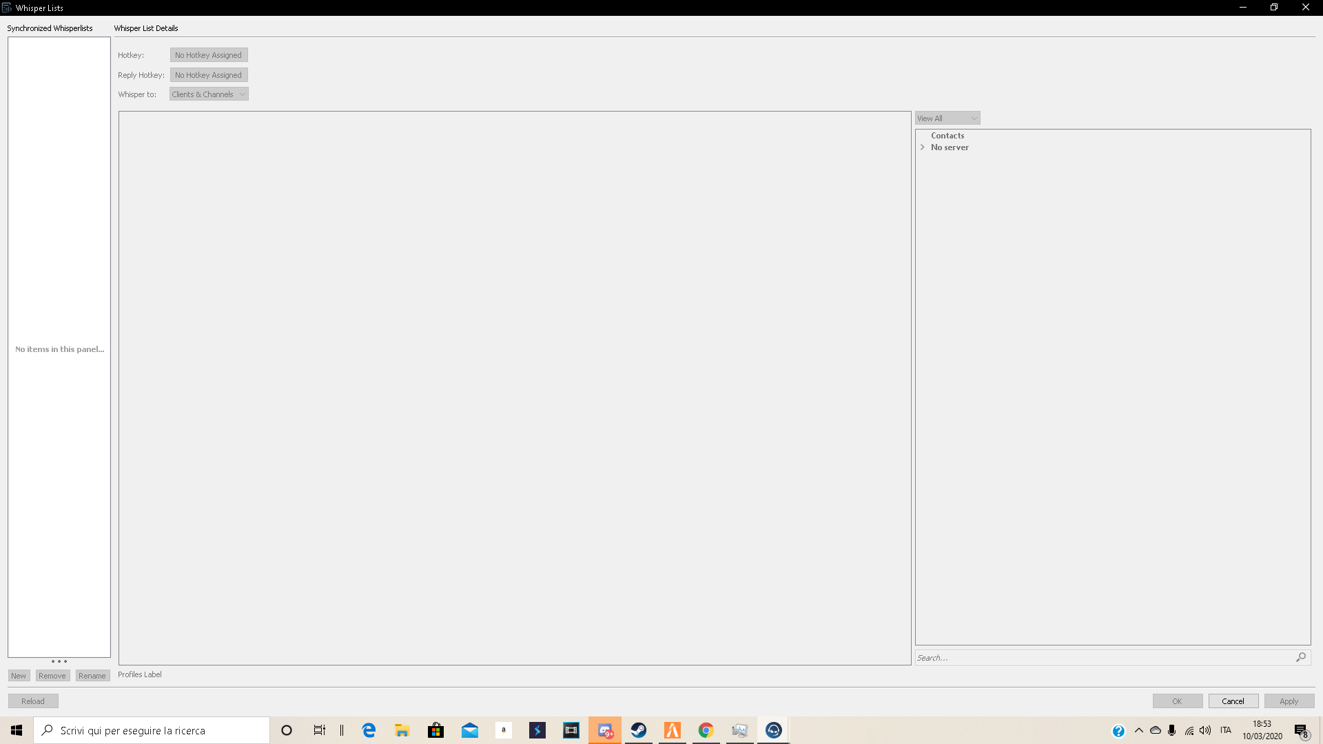

I am trying to config my whisper list but is not loading, I am connected to a server and all, buttons are not loading, only cancel button, please help

After then i updated my ts to the last version my whisper list lagged and i can’t do anything in that list
The same thing with bookmarks, but problem with them activates after then i opening laged whisper list
U see that?! whisper don’t work!! Pls I need help for this now!

Here are all the files that I have in the folder that I need to rename?
settings in your case. You do not see the .db as mentioned before.
btw if that does not help, please go up a folder and rename TS3client folder for testing.
I renamed this file, but the system created another one , in the end all the settings fell off, but the visper did not work. The folder is also renamed, the system creates the same.
