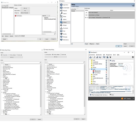

The same question MacKenrick has and no luck so far to have the Whisper option working.
I “fly” a fligth simulator (callsign “Mokum” in Falcon BMS) and would like to have comms between the fligth channels separately. Setup on my game stick:
  • Button 20 = “Push to Talk” and for comms in the same TS channel
  • Button 21 = “Push to Whisper” and for comms with other TS channels
Next picures that clarify some more (I hope :slight_smile: )
TS3-1
TS3-5
Thank you in advance!
But your images show that both hotkeys work as they should?
So what exactly do you mean with no luck so far ?
Hold in mind that you need at least on client to be targeted (sitting in one of these channels) or else you will get an error that no target was found. Technically you are always whispering to clients and not to channels.
Thank you for your reaction and detailed information. Appreciated :slight_smile:
I tested the whisper to clients with clients in a “target” channel, but that still won’t work. It probably has something to do with the permissions, rigth? Back in the day I (we) and at an other virtual figther wing used and it worked great, but… I was connected as a registered TS member. At the wing I fly now I’m registered as a TS Guest. That can be the case? I already posted this same question on the forum of this wing, but no answer yet.
Yes it could be that your Guest got no i_client_whisper_power and target user or channel requires a i_client_needed_whisper_power.
Own whisper power must be equal or higher than target’s needed whisper power.
