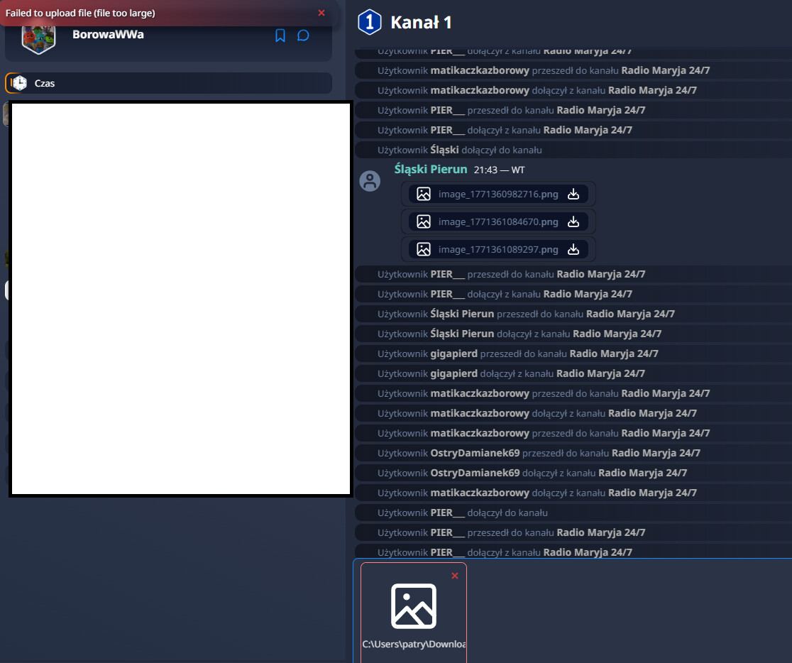

Is there any way to send a file larger than 5MB to chat?
I can t send a video to my friends on my selfhosted server
Hey, currently it’s not possible to send larger attachments in the chat.
You can support the idea of @Gamer92000
As a workaround you can upload files to the server storage, right-click a channel and click Browse Files. There you can upload your files, copy the URL and send it in chat.
