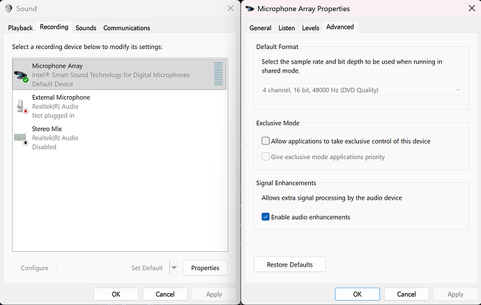

I have found an issue with the audio recording software on the Teamspeak 6 client.
This is reproducible every time i start Teamspeak 6 on my Lenovo Yoga Pro 9i 14 (14irp8).
The microphone gets picked correctly using the windows sound recording software, which is shown in the last part of the video below.
Here is a link showcasing the issue: https://youtu.be/I4-ZYZ7DknE
Is there any setting to change the channels of the microphone to 1?
Does something change when you disabled audio enhancements?
Can you please post a fresh client logs:

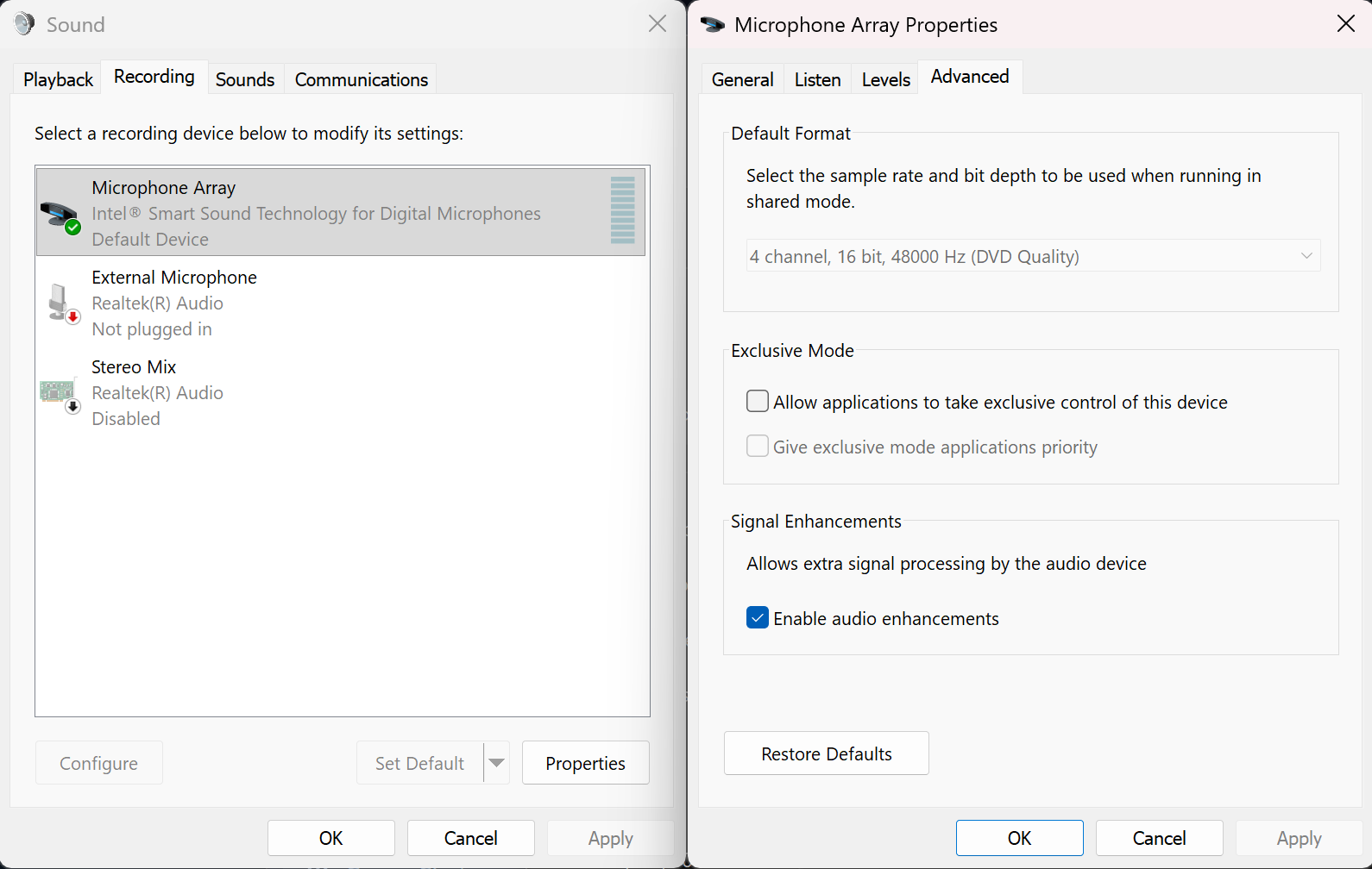

There are absolutely no settings that i can change. The only option available is the 4 channel mode (it is also greyed out as you can see on the image). There are no dedicated software to control it (which i can access at least)
Disabling audio enhancements also does not change anything, i tried that before making this post.
I am unable to post logs right now, i will do it tomorrow. Is it safe to dump the log on this thread?
Mostly yes, however if you are concerned, you can just DM it to me.
I have sent the logs in a DM
Thanks, I’ve found these drivers. Maybe those can help.
If that is not the case, then I can only suggest to try a software like Voicemeeter. It should then be able to mix all of those 4 microphones to one channel.
