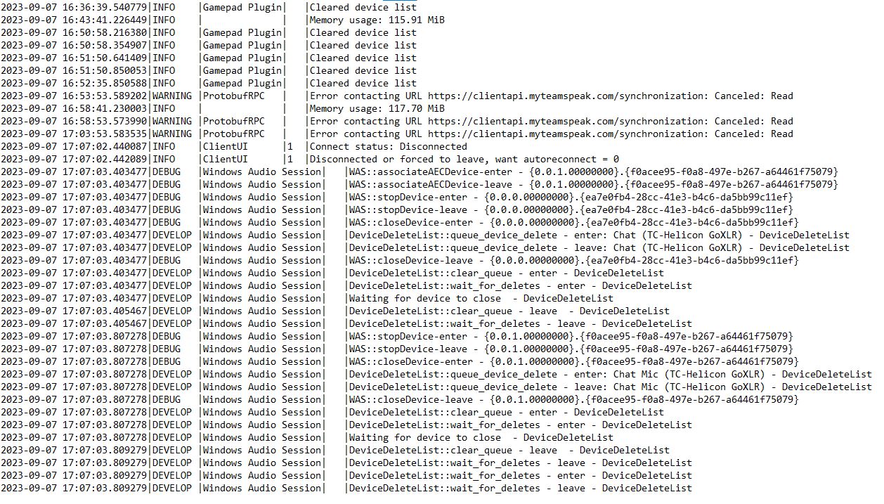

Issue first appeared on uh…3.5.something? Updated to 3.6.1 after it failed to sync, in case being behind was causing the problem (obviously not…)
I also tried turning off sync and turning it back on, in case that was the issue…but it also wasn’t, so now all my keybinds and stuff are gone, which is super cool.
I’d like to send you a log file but your incredibly advanced, modern, and well-designed forum doesn’t allow me to upload .txt files. Short version: this line appears several times, with no other lines that appear to be relevant.
07/09/2023 20:03:16 ProtobufRPC Warning Error contacting URL https://clientapi.myteamspeak.com/synchronization: Canceled: Read
ā€œFailed to synchronize with MyTeamSpeak accountā€. This appears to be a similar issue in relation to the above. As well as getting continuous errors on windows like other members here.
07.09.2023 18:49:12 ProtobufRPC Warning Error contacting URL https://clientapi.myteamspeak.com/synchronization: Canceled: Read

07-09-23 20:16:38	ProtobufRPC	Warning	Error contacting URL https://clientapi.myteamspeak.com/synchronization: Canceled: Read
Looks like as the API is returning a HTTP 500 error:

Yeah lost everything on my teamspeak due this problem but i can use my phone and log in perfect but when comes to pc everything broken worked fine this morning then boom gone
same here, just blank teamspeak even when i am logged on my account. happened around two hours ago.
Thank you for all the reports. We’ll be looking into this tomorrow morning and keep you all updated.
