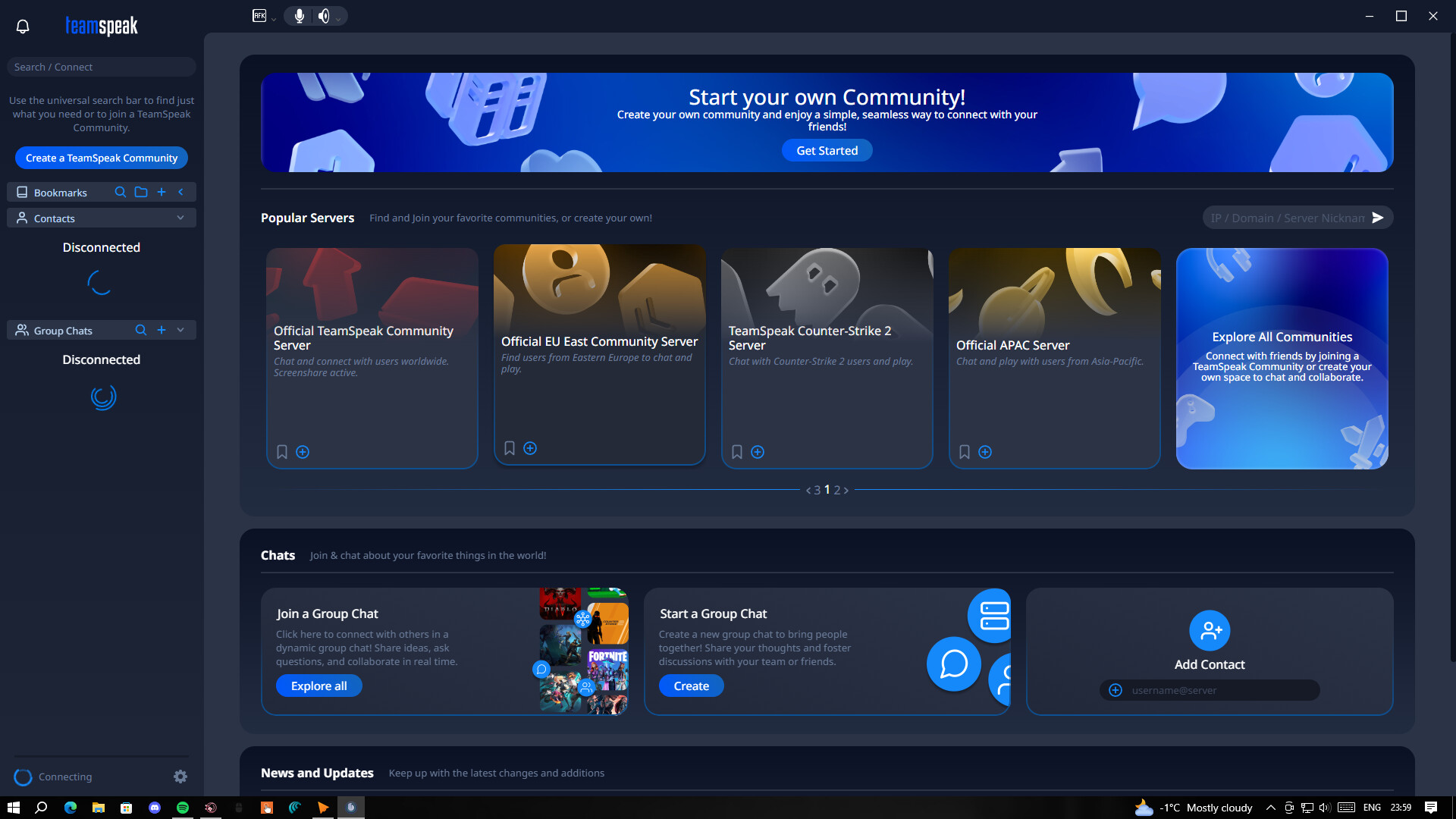

Disconnected from Chat / Messenger // You are not connected to chat services

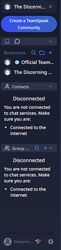

Having this same issue, Ive cleared my cache twice, reset my router, uninstalled and then reinstalled teamspeak and it still says im disconnected despite everything. I have a strong internet connection, no issues on any other programs, only teamspeak.
Happened to me today. Disconnected ,You are not connected to chat services. Make sure you are : connected to the internet.
Anyone able to help ? Im logged in to my teamspeak account but it says im not connected to internet . I loaded my laptop to see if it was my computers problem but i have same issue.
I thought it may be my internet so tried connecting to my phones hotspot but the same issue on both pc and laptop .
Is there an issue on teamspeaks end ?

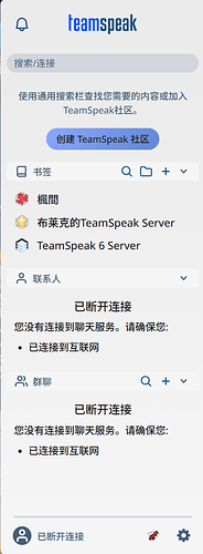

I am also disconnected from contacts and chats, it keeps trying to reconnect but it never does even tho i have internet and everything else. I can still join and talk in a server but thats it… any fix ? ty.
