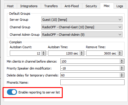

How do I block it on Linux?
It is exactly the same as in the Windows client. You have to join your server as a client with server admin rights. Right click on your server and then go to Manage Virtual Server > Misc > (untick) “Enable reporting to serverlist hit “Apply”. See this Picture below:
17310877116215822957017731377654
Otherwise:
You should have access to the “serveradmin” Server Query account.
Please establish a connection to the Server Query interface using any telnet client (such as Putty). The default query port is 10011. Please replace anything written in capital letters:
> login serveradmin SERVERADMIN_PASSWORD
> use port=VOICE_PORT_OF_SERVER_TO_BE_EDITED
> serveredit virtualserver_weblist_enabled=0
> quit
I hope this helps.
