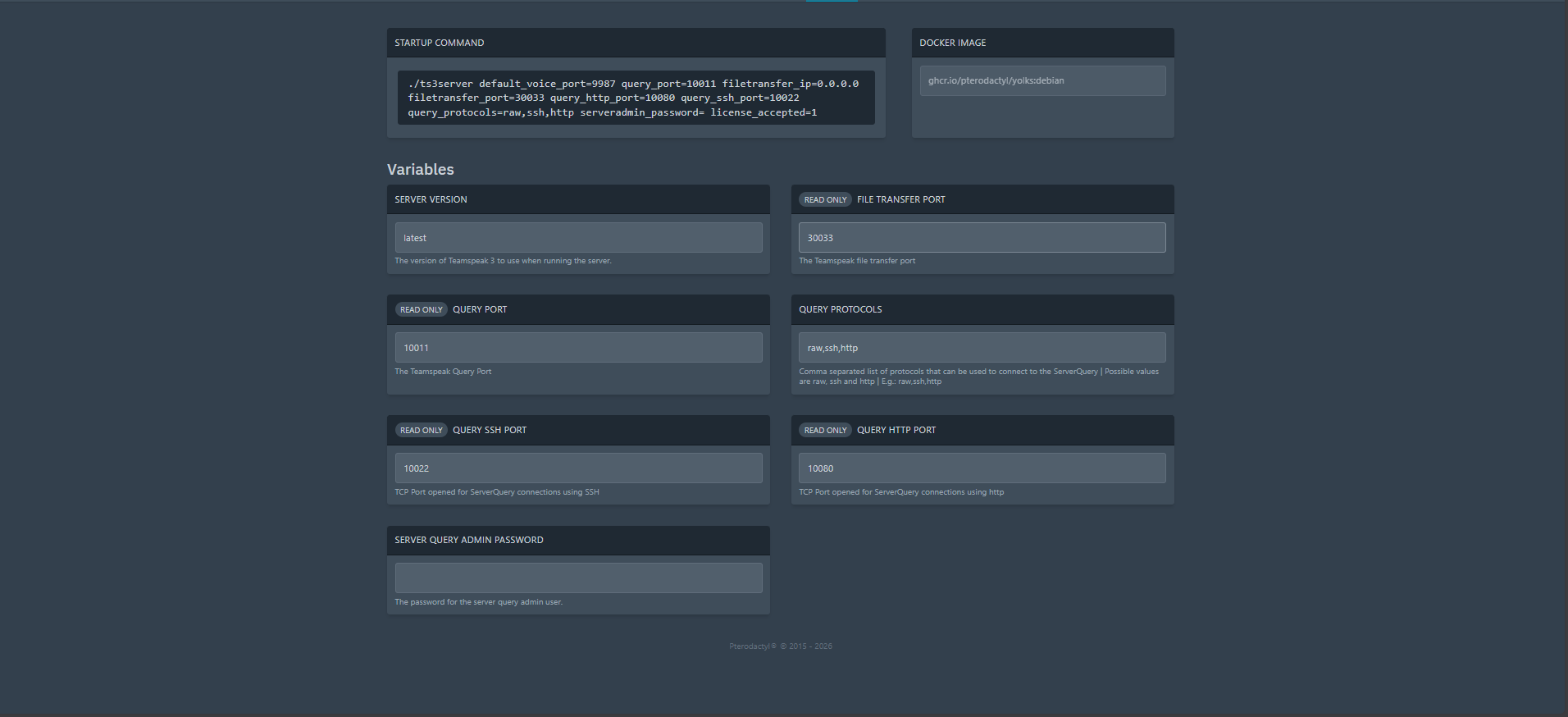

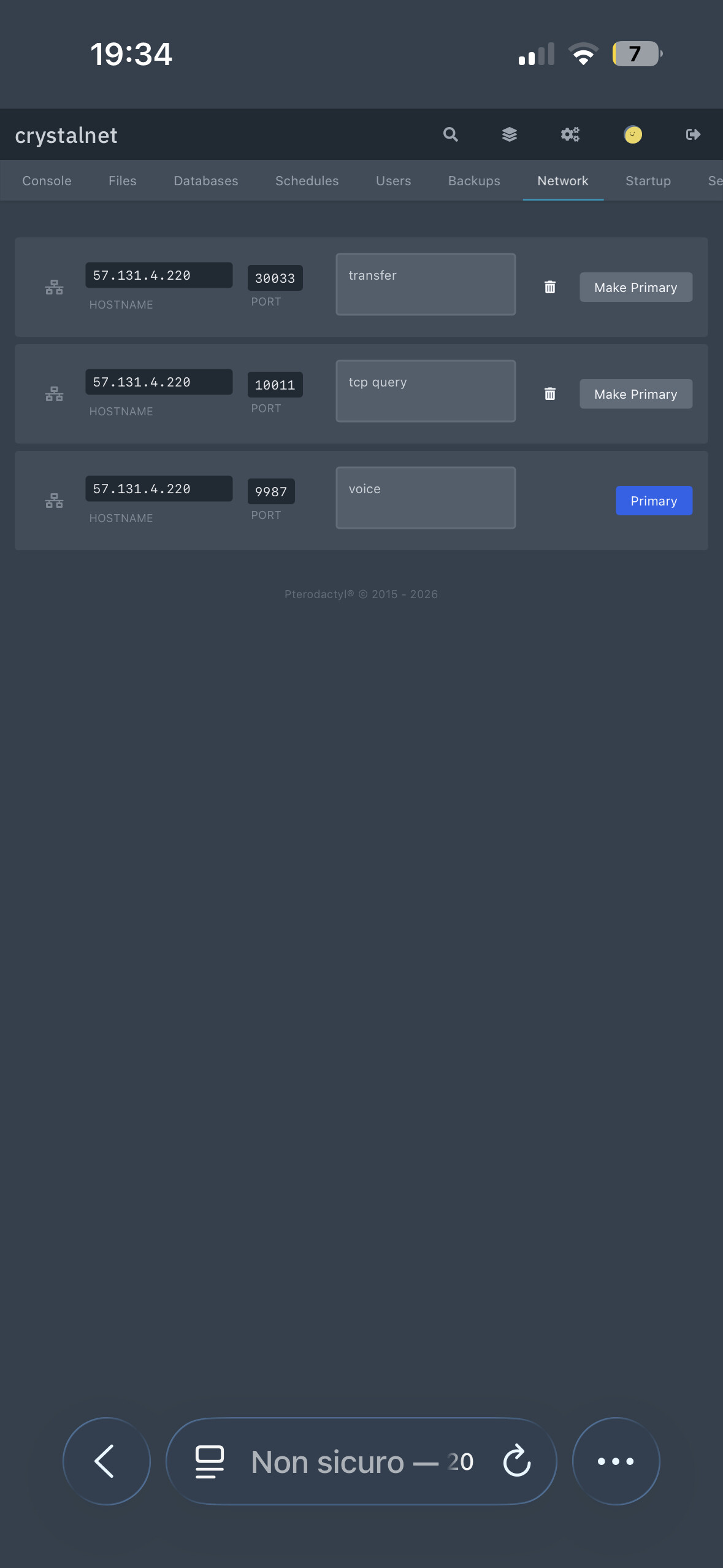

Hi, in my Pterodactyl panel console the following error keeps being spammed:
TS3ANetwork::Send failed error: 111
How can I fix it? The server is working fine, but this error keeps appearing continuously in the console logs.
