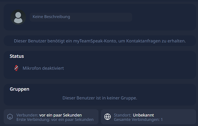

This is the error shown in the TS3 Client
The TeamSpeak server could not validate your myTeamSpeak ID. Some myTeamSpeak related services are not available.
Reconnecting might solve the issue. (it didn't)
myTeamSpeak ID is invalid

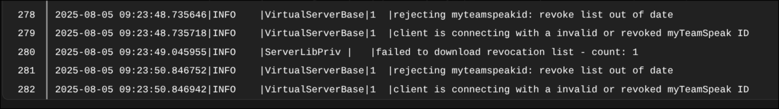

This is the error shown in the server logs.
failed to download revocation list - count: 4
rejecting myteamspeakid: revoke list out of date
client is connecting with a invalid or revoked myTeamSpeak ID
