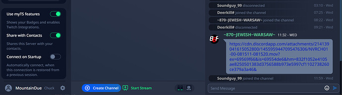

And I do have myTS enabled
Does the chat in the left sidebar work without issues?
What server version are you using?
Could you please check for any errors in the server.log
The chat is functioning well. I’m unsure how to check which version I’m using, but I pay a monthly fee for TeamSpeak 6 through their service. I’m currently researching how to find the server log, but I suspect that this information can only be accessed from the server side.
