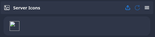

I can upload files in channels fine but I cannot upload server avatars or icons, as I’m receiving the error lost file transfer connection.
I can see in the filesystem that a file gets created, but without a file extension. After reloading in the TeamSpeak client, I can see that there’s an icon but it’s broken and doesn’t show the actual image.

Like I said, it creates a file in the icon directory but without any file extension. I don’t know if that’s normal. e.g. icon_1868990080.
