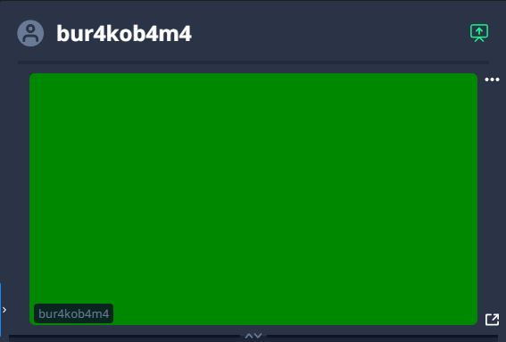

It’s not about audio for me. I can’t see the screen that my friends share with me. I can only see an green screen. But i can hear the stream. You need to fix this issue too.

As you can see i can’t even watch anything that my friend share with me. Stream stays like this if i stop watching stream than i can’t watch it again. It stays at waiting to be let in section. It’s not about clock or something. I don’t know why is this happened. Can you solve this?

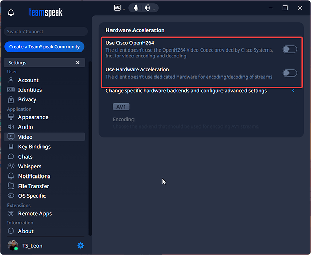

After a bit back and forth it looks like the system does not support our current implementation of Hardware Acceleration. We’ll investigate this issue and determine if it can be fixed / to disable Hardware Acceleration if the system does not support it.

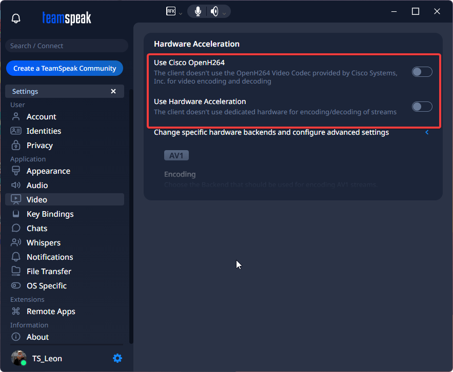

As a workaround you can turn it off in the Video tab of the settings and the streams will work again.
Hey @buraninyo please retest hw acceleration again with beta4 as soon as it’s released

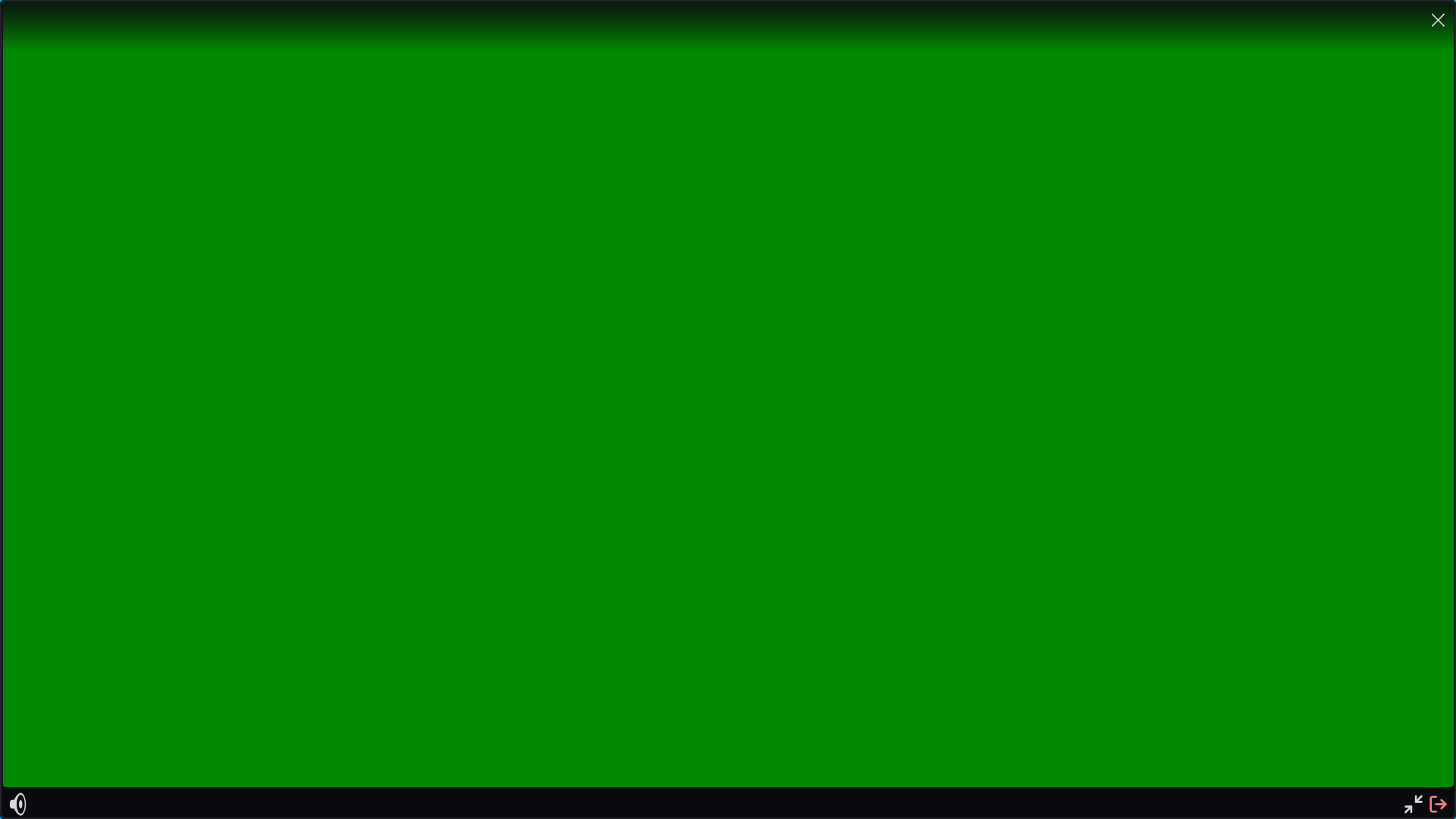

Device: Intel Arc B580
I can not decode the screen share by av1_qsv, it will be a green screen.
But I can decode it by software decoding. How can I make mine graphic cards can decode this av1 stream?
