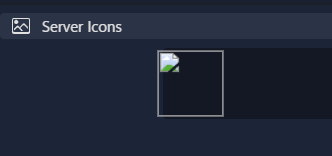

Hi, Iâm running a personal TS Server on my windows machine and have set-up the File Transfer port correctly, Iâm able to transfer files through channelsâ chats, but when uploading them as icons for the server, they appear blank.
The limit of my role for max icon size is high enough, so what am I missing?
In 99% the icons are no longer available on Serverâs hard drive or port for file transfer is not opened.
The server owner must fix this.
Those files are not transferred over the server but the myTeamSpeak system. So, something with you file transfer settings / port is incorrect. By default it is TCP 30033 and the port needs to be open for incoming traffic / redirected everywhere your voice port is as well.
30033 Port is open and redirects to the correct IP.
Is there any error in server or client log?
Is this file an image at all? We had cases in the past files had wrong file endings and itâs content wasnât a valid image at all. With tools like IrfanView you can identify such images. It would print a request to change file endings.
No error message, it even shows up as successfully uploaded,
2024-04-23 17:40:40.290334|INFO |VirtualServerBase|1 |file upload to (id:0), '/icon_408382813' by client 'Asviix'(id:3)
And Iâve tried with multiple known âtrueâ .jpg files
Iâm not sure about this but another reason could be that the server has no permission to write the files on the host machine.
