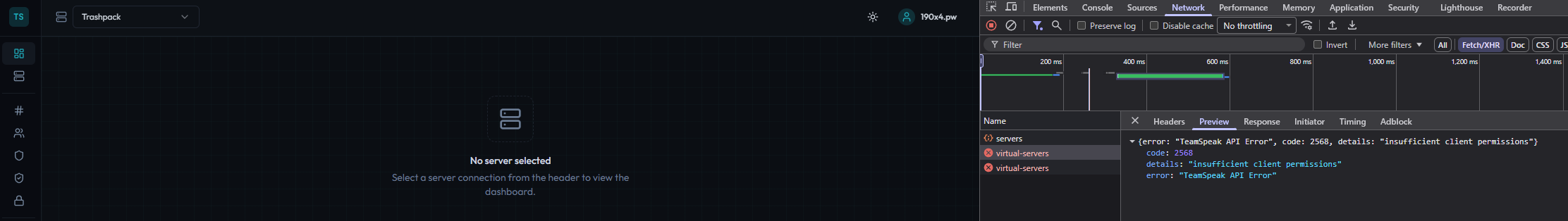

Hi, great job, thanks! Please tell me how to fix the error:
It feels like the serveradmin doesn’t really have access rights to the instance in the TS database. Is there a solution?
looks like the server query is not able to join a client in the server to acces the data due to insufficient permissions. :thinking:
Yes, that’s right. But the rights are there, the API has been received. Will only reinstalling help?
you using the docker images or do you build from source?
I’m using the official Docker image: teamspeaksystems/teamspeak6-server:latest
I’m using the official Docker image teamspeaksystems/teamspeak6-server:latest. The serveradmin account seems to have lost its instance-level permissions. Even when connecting via SSH query (use sid=0) and trying to run instanceinfo or serverlist, I get error 2568 with failed_permission=b_serverinstance_virtualserver_list.
I have a valid WebQuery API key (created with sid=0), but it also returns the same error 2568. The TS6 Manager dashboard shows “No server selected” because of this.
I tried recreating the Docker container, but the permissions were not restored since the data volume (ts6_data) was preserved. Is there a way to fix serveradmin instance permissions without wiping the volume and losing all server data (channels, groups, clients)?
FIXED.
The issue was a missing permission in the TS6 SQLite database. The b_serverinstance_virtualserver_list permission was completely absent from the perm_server_group table for any group.
The fix was to manually insert it for the Server Admin group (id=3, server_id=0):
sql
INSERT INTO perm_server_group (server_id, id1, id2, perm_id, perm_value, perm_negated, perm_skip)
VALUES (0, 3, 0, 'b_serverinstance_virtualserver_list', 1, 0, 0);
After restarting the TeamSpeak container, everything started working. Not sure how this permission got removed — possibly related to container recreation or multiple serveradmin password changes.
