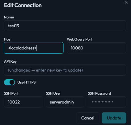

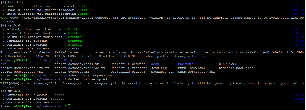

Seen a lot of stuff being done, because it was building. In the end I need to make a change in the docker-compose.yml file, since port 3000 was already taken by a different application.
After changing the port to 3010, I ran the command docker compose up -d, which initiated the containers.
All images are succesfully up and running, and was able to make an admin account. After logging in, I added the http side of things, which works instantly. Here I used the loacal IP address of the device docker is running on.

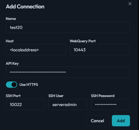

After that I added a second connection, to try to get https working. Here I used the same IP address as the http one.
After saving the new connection, I still receive the same error:
[Error] TSApiError: Client network socket disconnected before secure TLS connection was established
Prisma was updated after the warning message was displayed in the logs.
Any suggestion is most welcome ^^
Many thanks in advance!
There is a typo in your environment variables:
- RSSERVER_QUERY_HTTPS_ENABLED=true
it should be
- TSSERVER_QUERY_HTTPS_ENABLED=true
You also need to add the HTTPS port mapping under ports:
ports:
  - "10443:10443/tcp"  # Web Query HTTPS
After fixing both, restart the TS server and update the WebQuery Port in ts6-manager from 10080 to 10443.
Sorry for not catching this earlier!

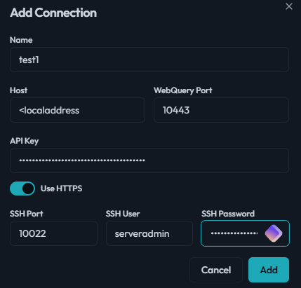

After the check, I add the connection using HTTPS
Still getting the following error:
{4D2FA8E5-42DE-4193-A225-4333D78775F7}
Since I feel we’re almost at the finish line, any suggestions are most welcome :’)
Many thanks in advance !
UPDATE
IT WORKS !!
Seems I misplaced the location where I added the .env file :’)
Thanks again for all the help! Issue resolved !

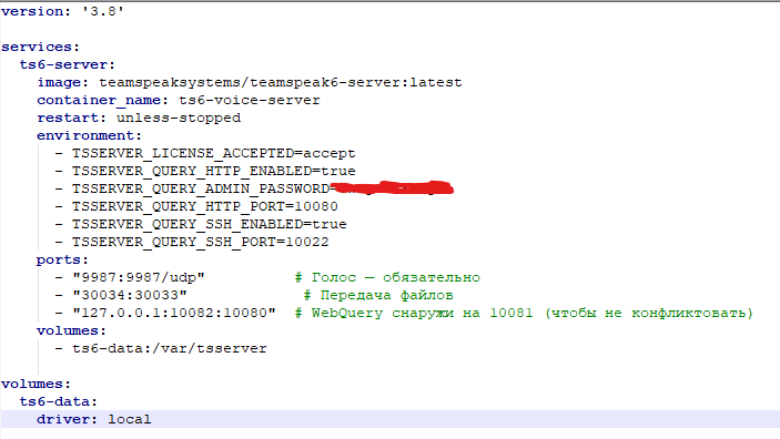

Hello. Im trying to create server in Docker (you recommended it). Im already launched it, this is my server .yml file
In docker im also launched your interface (docker-compose.yml). Problem is in “server connections” in settings. Program says “Connection successfull” when i trying button “Test”, but i don’t see any info.
So TS6 Manager can’t connect to my server. Can someone help me, please? I can’t program, its AI helped me with all code and some messages from this thread. Im edited docker-compose.yml (I have changed ports like in server file). Also sorry for my english, its not my main language
I think this may be a Docker networking issue.
In your TeamSpeak compose file you expose the WebQuery port like this: 127.0.0.1:10082:10080. That means the WebQuery port is only available on localhost of the Docker host.
If TS6 Manager is also running inside Docker, using 127.0.0.1 or localhost in the manager will not point to your TeamSpeak server container. It will point to the TS6 Manager container itself.
If both containers are in the same Docker network, try using the container/service name as the host:
Host: ts6-server
Port: 10080
So the manager connects directly to the internal container port, not to the host-mapped port.
If TS6 Manager is running outside Docker, then you should connect to the mapped host port instead, for example:
Host: 127.0.0.1
Port: 10082
Also make sure the port matches your compose file. Your comment mentions 10081, but the actual mapping in the screenshot is 10082.
So I would first check:
  1. Are both containers in the same Docker network?
  2. Is TS6 Manager using ts6-server:10080 when running inside Docker?
  3. Or is it using 127.0.0.1:10082 when running on the host?
  4. Do the TS6 Manager backend logs show any error after pressing “Test” or loading the server info?
“Connection successful” may only mean that the endpoint is reachable, but if no server information appears afterwards, the manager may still be using the wrong host/port or not receiving the expected WebQuery response.
