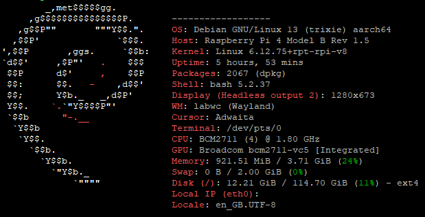

Though my knowledge is limited, and since TS6 supports ARM cpu’s now, I used docker to install both the ts6 server and ts6-manager on my raspberry pi.
The ts6 server works 100%, as I’m able to make changes to it and see traffic when using voice etc. The ts6-manager seems to work propetly. However, when adding the connection under Settings, ts6-manager is unable to load the ts6 server. Upon checking the backend logs, I found the following:

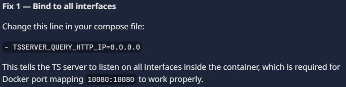

Hey,
the issue is identifiable from your config. A few things to address:
Root Cause: TSSERVER_QUERY_HTTP_IP=<localaddress>
You’re binding the HTTP query interface to your Raspberry Pi’s LAN IP (e.g. 192.168.x.x). A Docker container doesn’t recognize the host’s LAN IP as one of its own network interfaces — so the TS server either doesn’t bind correctly, or the port mapping doesn’t work as expected.
Fix 1 — Bind to all interfaces
Change this line in your compose file:
- TSSERVER_QUERY_HTTP_IP=0.0.0.0
This tells the TS server to listen on all interfaces inside the container, which is required for Docker port mapping 10080:10080 to work properly.
Fix 2 — Container-to-container communication
If ts6-manager is also running as a Docker container (in the same Compose file or network), do not use the Pi’s LAN IP as the host in the ts6-manager settings. Use the service name instead:
Host: teamspeak Port: 10080
Docker has built-in DNS resolution for service names within the same network. The LAN IP only works reliably if you’re using network_mode: host.

Hi @Domeninchen ,
Thank you for reaching out and providing a very detailed explanation.
This information did helped me a lot, and was able to resolve the issue. Main issue was the IP binding part!
Thanks a million! :flexed_biceps:
