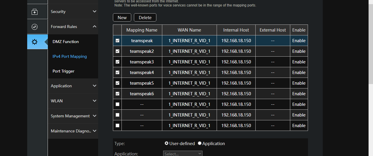

look ive done everything everypossible thing ive port fowarded ive enabled in firewall i even got my isp to port foward but i cant join my server thro external ip yes i asked friends to join they timeout i use teamspeak 3 please i just want a private server for me and my friends and another weird thing is that i put a password on it but on server list it shows with no password
Are you able to connect to your server with address localhost?
yes
sorry for late reply im in gmt +5 its 7 41 am rn lol
and i checked to see if ports were open but there not apparently i am so confused
i even got my isp to do it but still to no avail
I can’t connect to my server that I created locally and that I shared on the network by opening the doors but I can’t do ninte per conetter
Please have a look at this Post: [Solved] Hosting a TS3 Server at home
