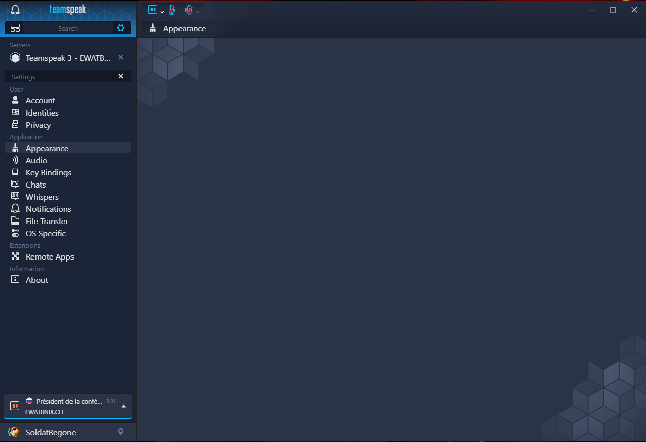

Update 5.0.0-beta75 is unfortunately a bit of a mess right now.
It causes the appearance menu to not load at all, regardless of whether any user themes were loaded or not.

Can you provide more details on this? Several installations run fine and open the view correctly.

I found the reason why the appearance settings were not opening. In your files you should see a preferences.json
On Windows it is here → %AppData%\TeamSpeak\Default
On Linux it is here → ~/.config/TeamSpeak/Default/
On macOS it is here → ~/Library/Preferences/TeamSpeak/Default/
(Default is your default Profile for TeamSpeak if nothing else is specified.
In this file you should specify the language of choice. Either German or English:
If it is empty or does not exist just add this or create the file and add this:
{"application.language":"en"} [ENGLISH] or {"application.language":"de"} [GERMAN]
If there is already something inside, you’ll need to format the content like this:
{"application.language":"en","application.mute_mic_on_lock":true} [ENGLISH] or {"application.language":"de","application.mute_mic_on_lock":true} [GERMAN]
→ this is just an example and may be different depending on your settings. Just make sure you’ll place the language part inside the curly braces with a comma spacing the other setting parts.
