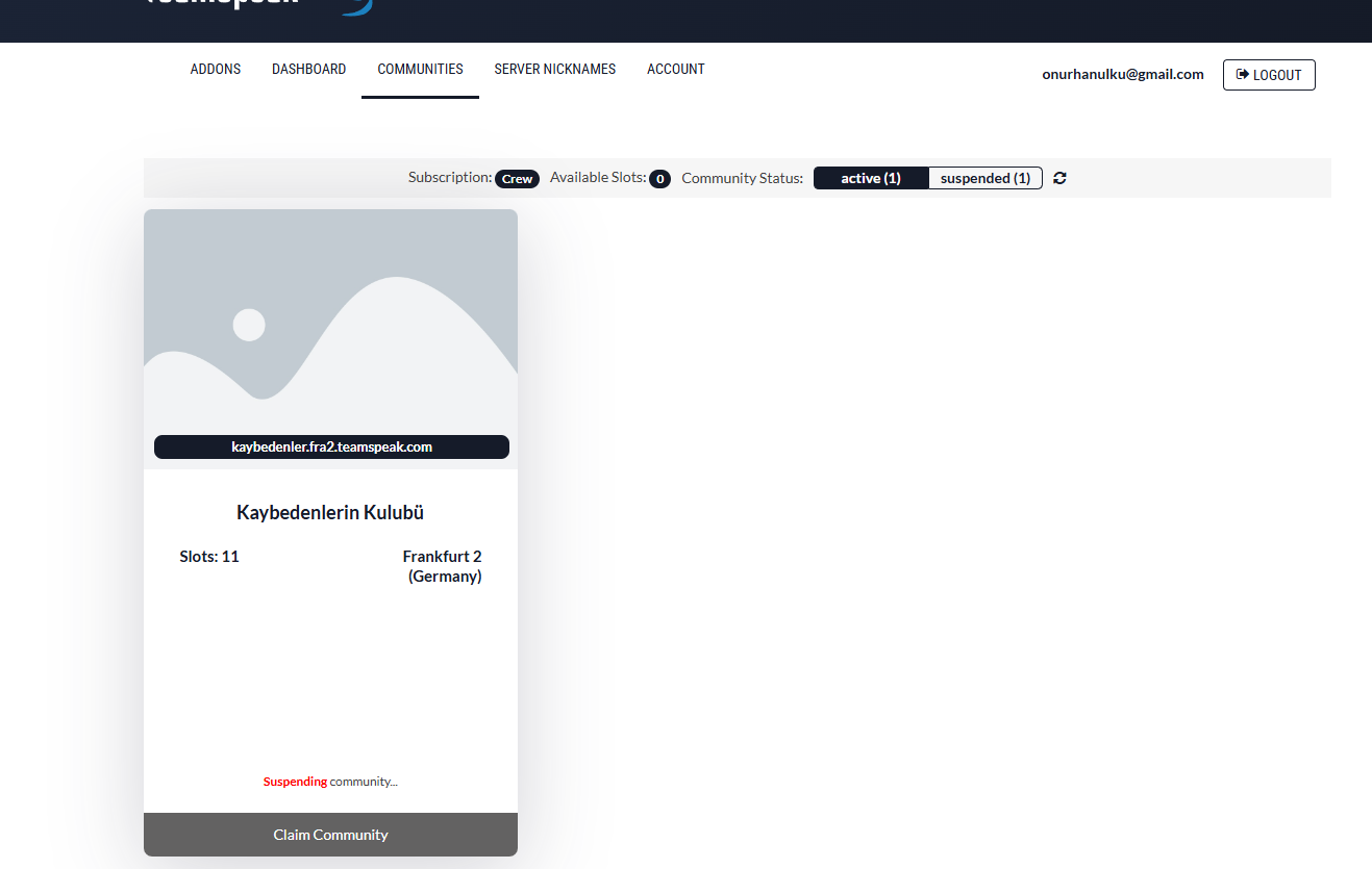

  • If you are using a Community, it might take a bit until the server is started and all network changes are made before you are able to connect. Based on the demand of servers that are created this may take a few minutes or even a few hours. We apologize in the meantime for the inconvenience.
  • If you still have issues when connecting, you may try suspending and creating a new one.
  • Sometimes it is helpful when you select a different server location.
  • If you still can not connect the Community, please reach out to support@teamspeak.com, they are able to restart the server, or perform refunds if you are unsatisfied with the current situation.

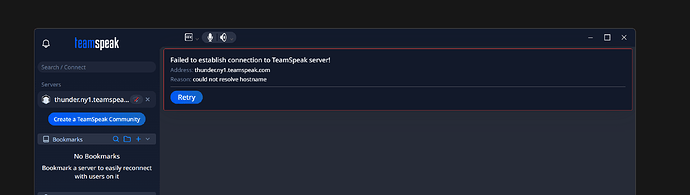

I had no issues logging into and connecting to the Tmspk3 server, until I left town and used Starlink connection. Then I came home and am unable to connect to server. I have gone through many changes IPconfig release, renew, cland ipv4 and 6 files. No matter what I’ve tried, I’m unable to connect to server, though I can ping and trace Tmspk 3 with no issue. I have reset my router several times, cleaned out temp files and optimized, still without success. Any suggestions?
When trying to connect to my community through the TeamSpeak 6 client, I get an error saying “could not resolve hostname”. This does not happen when I connect through the TeamSpeak 3 client.
My friends have been able to connect fine through TeamSpeak 6.
I have tried connecting through them and adding the community as a bookmark, but neither works.
I can connect to other communities in the TeamSpeak 6 client, like the official North America Server.
I’ve generated multiple invite links for my friend, had both of us attempt to uninstall and reinstall the client, gave him the subdomain, and no matter what he cannot join the server. It works fine otherwise for me and 5 of my other friends. Myself and the friend who cannot join both have out clients totally up to date if that’s relevant. We’re both a bit frustrated as this has been an issue for over a week now, and each new attempt has resulted in failure. Any help would be appreciated.
Since you can ping and traceroute the server successfully, the destination is reachable at the network level, but that doesn’t necessarily mean TeamSpeak’s UDP connection is getting through.
TeamSpeak 3 uses UDP port 9987 by default, although the server may use a different port.
I’d suggest checking a few things:
  1. Can you connect to other TeamSpeak servers, such as voice.teamspeak.com?
  2. Have you tried connecting directly using the server’s IP address and port instead of its hostname?
  3. Can you connect to the same server using a different connection, such as your phone’s mobile hotspot?
  4. If it’s only this particular server, could the server administrator check whether your current public IP address is being blocked by the server firewall or ban list?
Since you’ve already tried resetting your network settings and router, I wouldn’t recommend repeating those steps.
Also, could you share the exact error message from TeamSpeak and the relevant entries from the Client Log when the connection fails?
That’s a strange one, especially since you can connect through TeamSpeak 3 and your friends have no issues using TeamSpeak 6.
Have you tried connecting directly using the server’s IP address and port instead of the community hostname?
I’d also be curious whether it works when using a different connection, like your phone’s mobile hotspot. That could help narrow down whether it’s related to DNS or something specific to the TeamSpeak 6 client.
If neither works, could you share the relevant client log entries from when the error occurs?

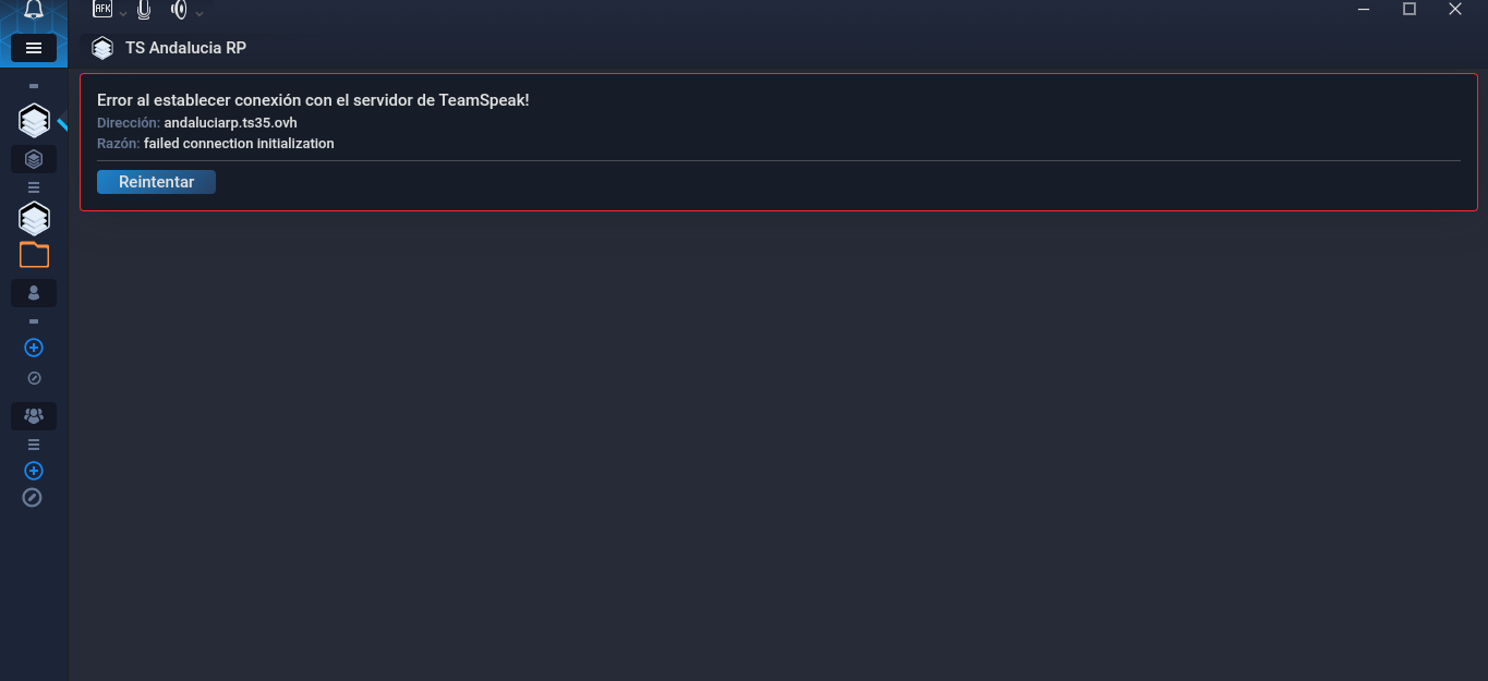

Good Morning I tried everything to get my TeamSpeak to work, but one day i login to my computer and i get a message saying “failed connection initialization”. I deleted all folders and the app multiple times and I cannot even join the public community servers. Everything else on my computer works fine I just need someone’s help here because Its aggravating. thanks
Hey @sskolo,
Could you tell me which operating system and TeamSpeak version you’re using?
Also, have you tried connecting through TeamSpeak 3 to see if that works?
If possible, could you share the client log from when the error occurs?

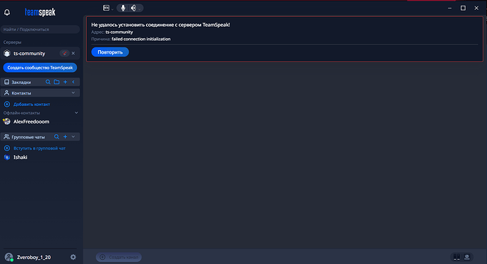

having a failed connection initialization and cant seem to load into public servers either.
tried clearing the cache no luck.
tried reinstalling no luck.
but my friends can join my server and i can’t?
did you ever figure it out because i’am having those same issues

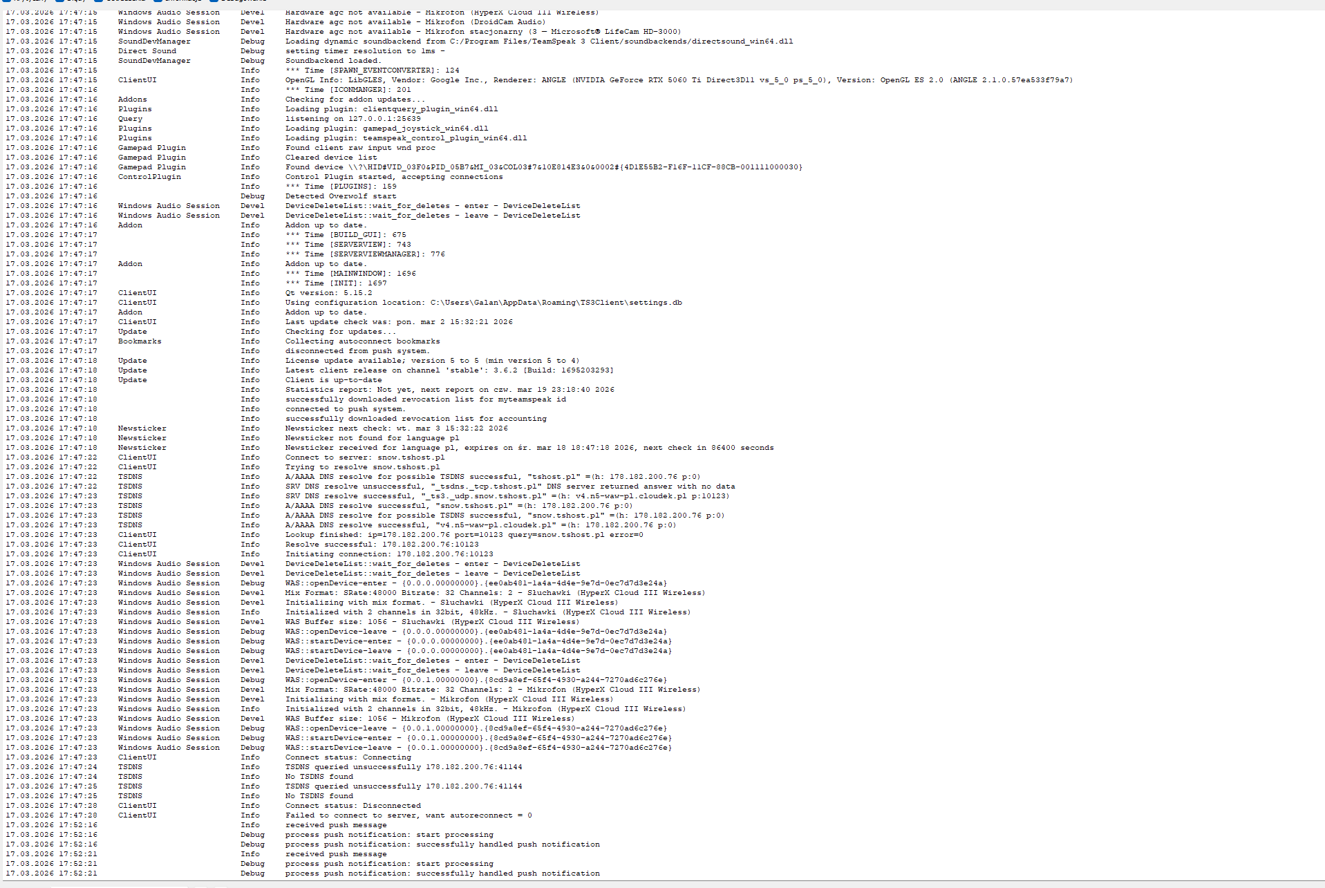

not sure why but my friends can connect to it but i can’t, but it says missing TSDNS in the logs
Can you connect to any other server such as voice.teamspeak.com or community from the discovery list, or does every connection fail with “failed connection initialization”?
Since your friends can connect successfully, the server itself appears to be available, and the problem may be specific to your client or network.
It says missing TMDNS in the logs.
Do you mean TSDNS? A line such as No TSDNS found does not necessarily identify the cause. TSDNS is an optional address-resolution method, and the client may continue by resolving other DNS records afterward.
yes it does say no TSDNS and no i cannot connect to anything else
Since you can’t connect to any TeamSpeak server, I’d say the issue is probably not related to your own server, especially since your friends can connect without any problems.
The “No TSDNS found” message isn’t necessarily an error, so I wouldn’t focus too much on that for now.
Have you tried connecting to a server using its IP address instead of the hostname?
I’d also be interested to know whether you can connect using TeamSpeak 3, and whether TeamSpeak 6 works when you switch to a different network, such as your phone’s mobile hotspot.
If neither works, could you share which operating system and TeamSpeak version you’re using, along with the relevant client log entries from a failed connection attempt?
